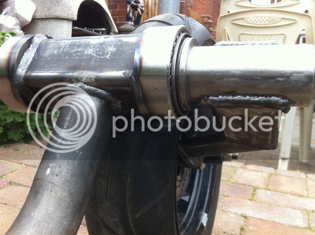

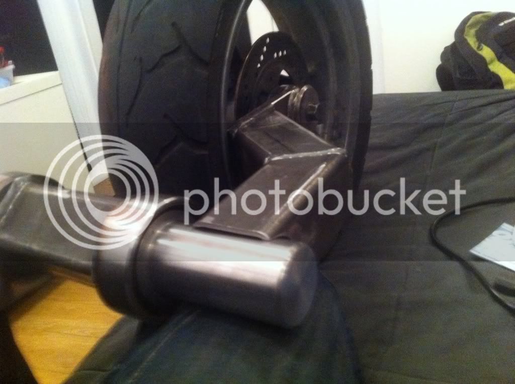

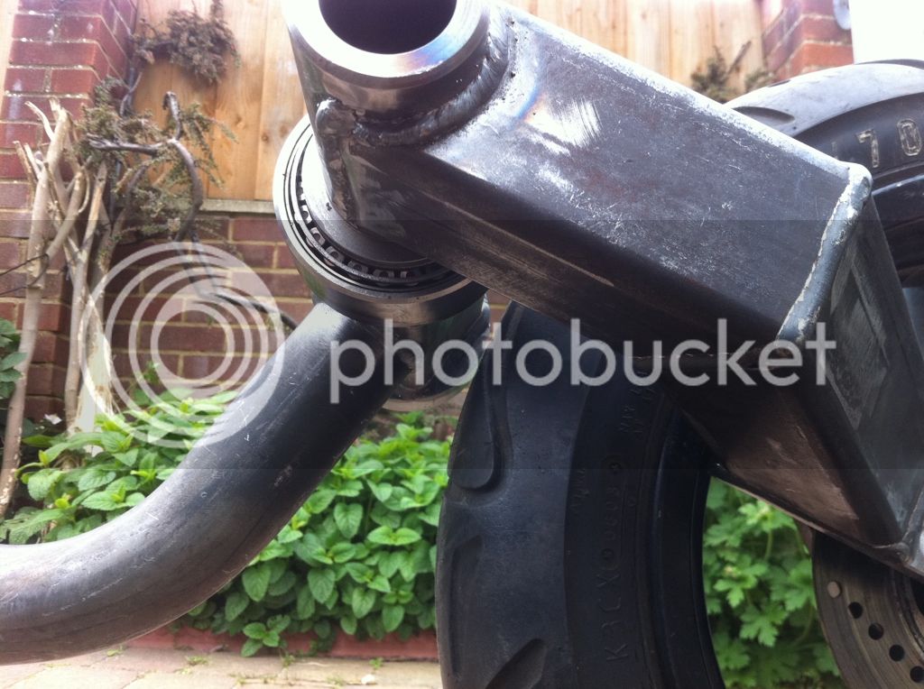

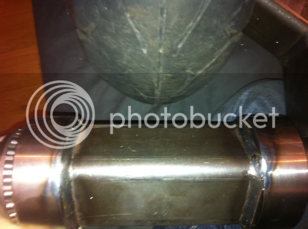

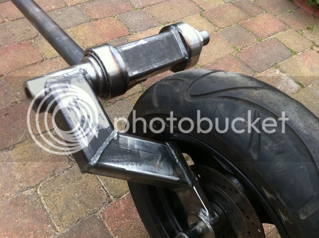

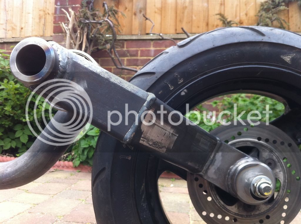

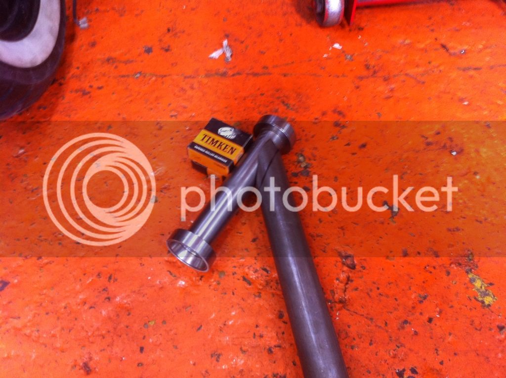

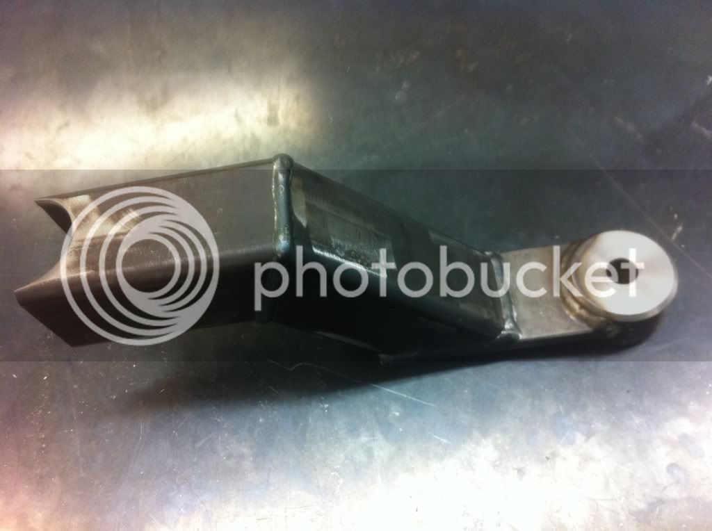

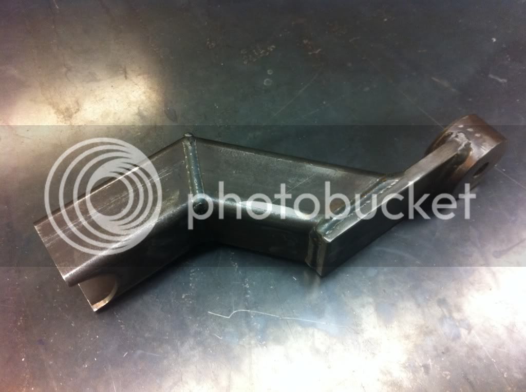

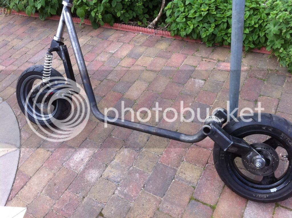

Been busy finishing the swing arm. This was all trial and error, and especially difficult to get the measurements right. I have changed the design again. Gone for a 12mm plate with a bush welded on the end. This looks far better.I need to make a brake mount for the calliper but apart from that is finished.
Frame should come together pretty quick now. The most of it was the rear swing arm. Motor mounts and battery boxes are a while away. Will be building these around a rolling frame, so have not even thought about how these will look yet.
Some pictures of progress.

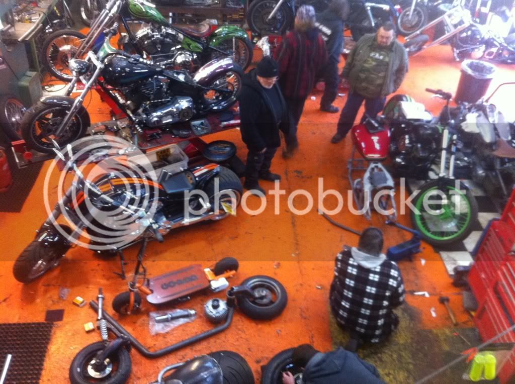

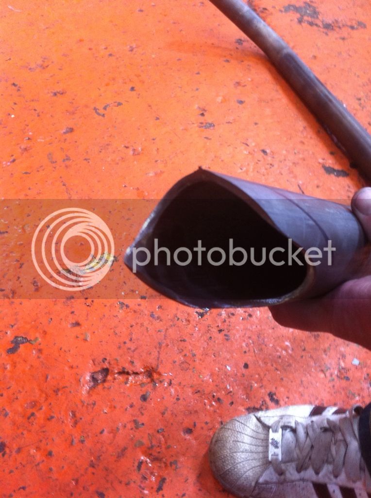

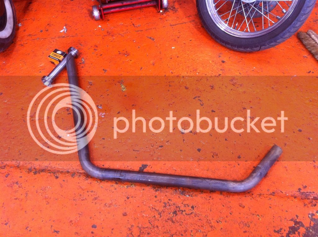

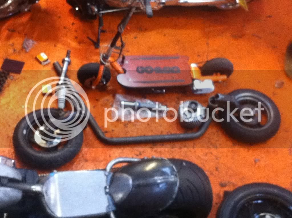

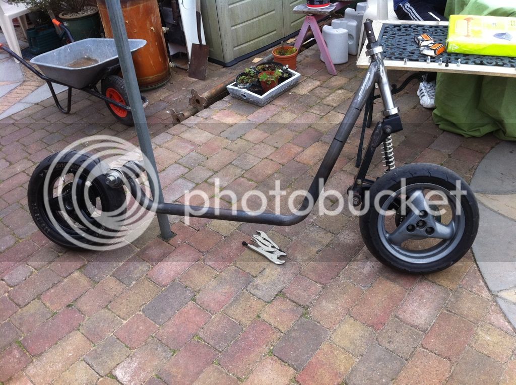

Here's a few more pictures. Got the frame parts laid out on the floor including motor. The bends are going to get cnc bent to this mock up, as the bender kinked the pipe. Definitely look like the odd one out against all the choppers in the workshop lol.

Ok, got some progress back on this project now.

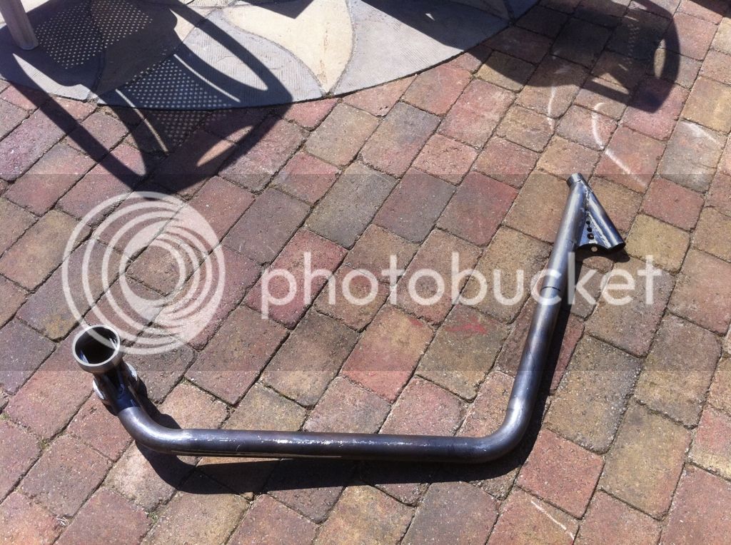

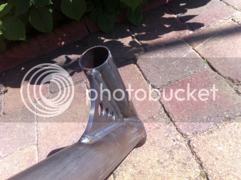

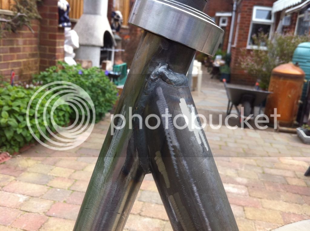

Had waited for nearly 3 months for the tube to be bent. It was 50mm 3.5mm thickness I think, and the bends where getting closer to 90 degrees. As soon as got the tube back started working on the notch in the pipe to take the head tube. Not the easiest of task, took a short while but am happy with it.
Hopefully should be getting the thing in a jig tomorrow to square it all off and weld the head tube in place.
Here's a few picture of where I am at.

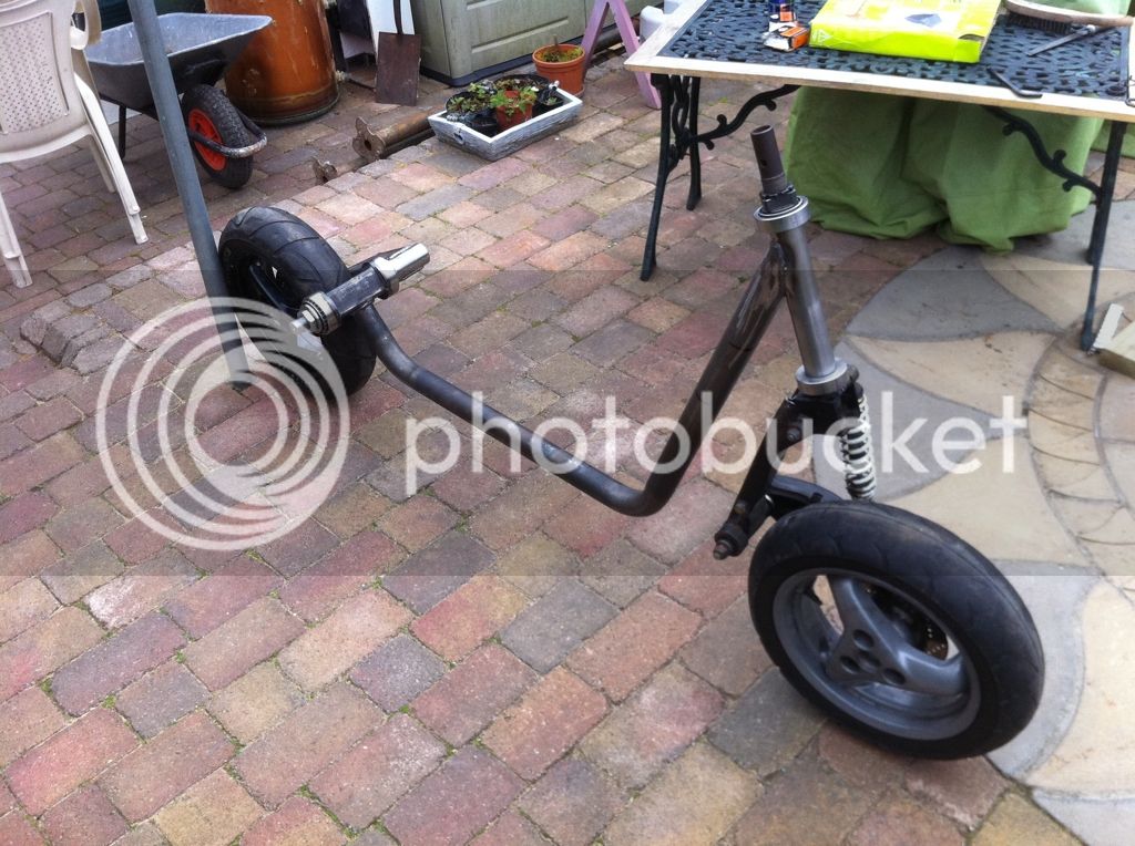

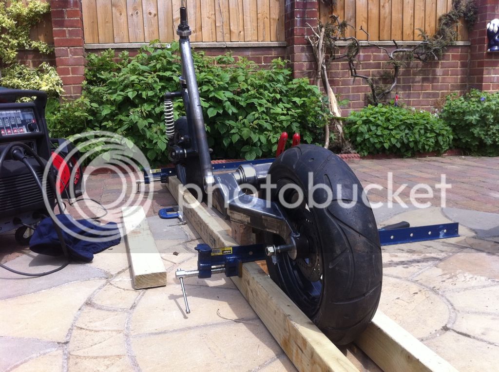

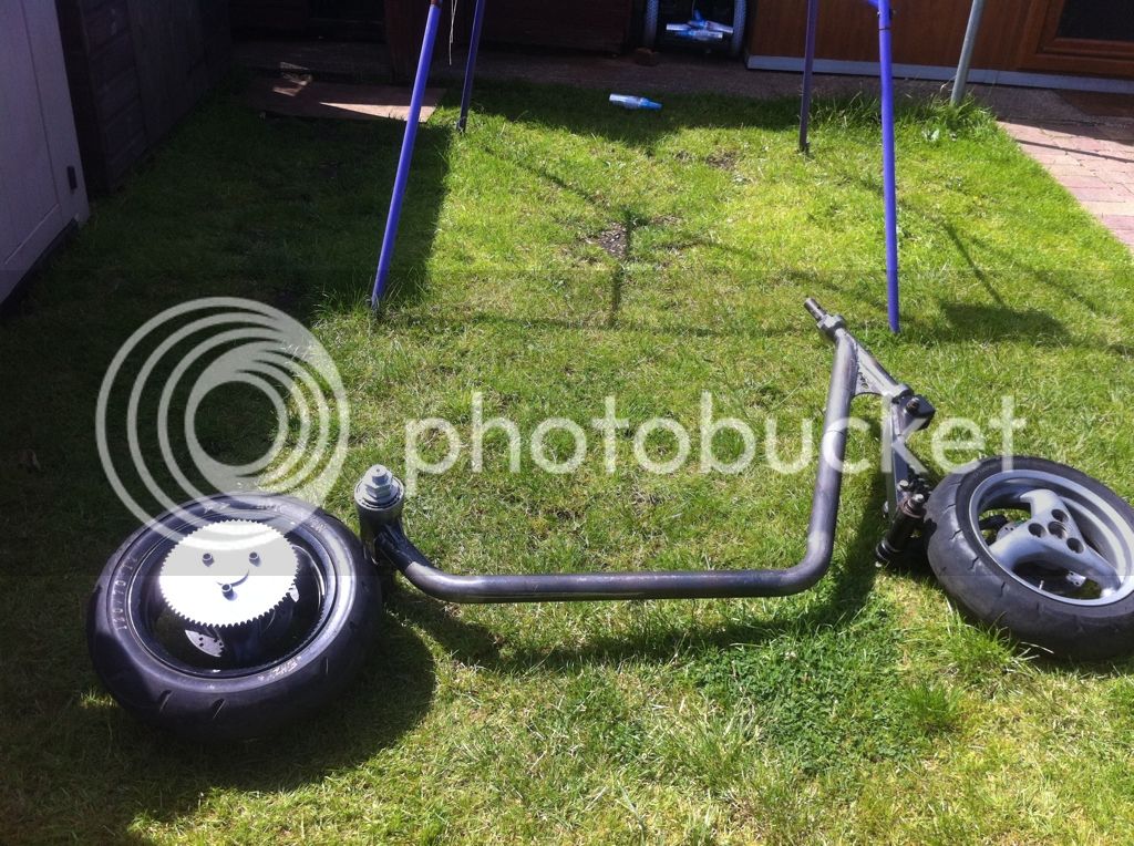

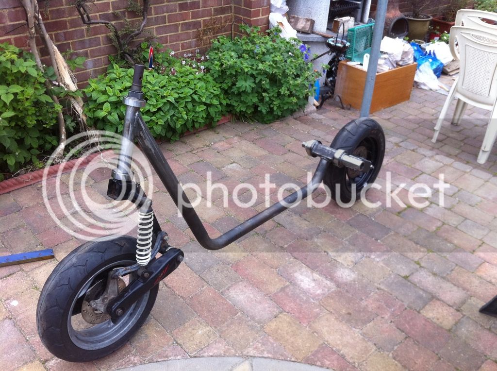

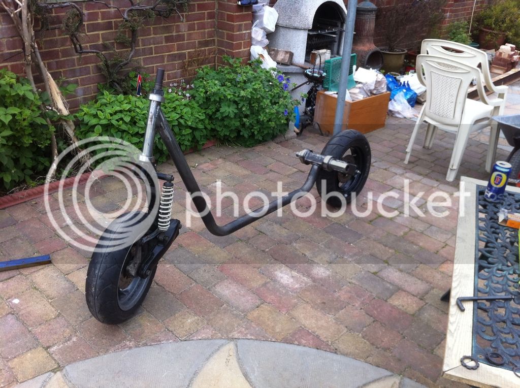

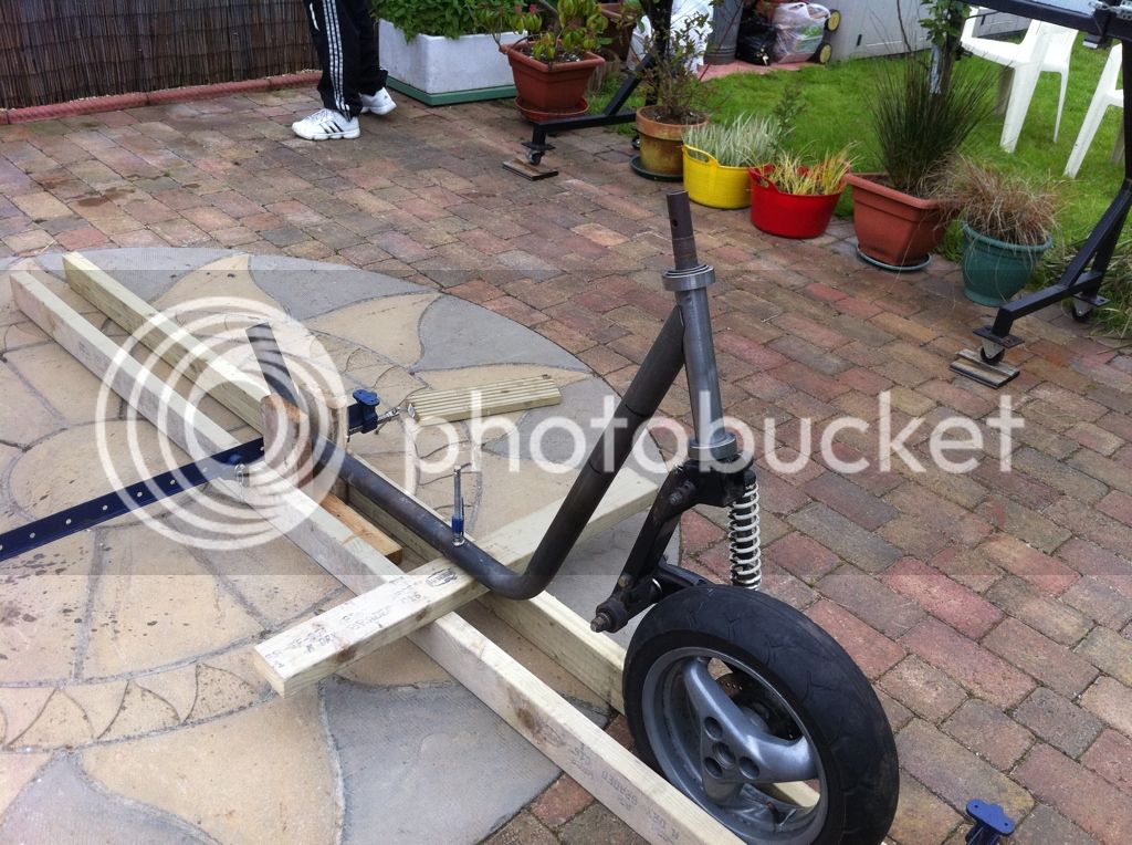

Been working on this again. Ended up making a make do jig out of wood. Seem to do the trick. Have a rolling frame now. There is a few gussets to be made to reinforce the frame, but other than that this is how it should look. Might shorten it a bit seems quite long but I have not mounted the motor yet which will take up some deck space. I locked the rear suspension in position at the moment. Have not made a tool to get the poly in yet. Frame is a bit big to get it a press now. Here is a few pictures of where I am at.
Looking great, thanks for updates!
It is definitely "super sized" but overall proportions look good to my eye. I'm very curious how the front sus works? 'should eliminate dive under front braking, yes? That's a helpful thing with standup scooters with so little ground clearance to start with.
Cool build...
Thanks Ykick. Not entirely sure of the technicals about the front suspension. I used this style because it was a single sided swing arm, where I am basing this on a GoPed I felt this would be best as they are supported single sided aswell.

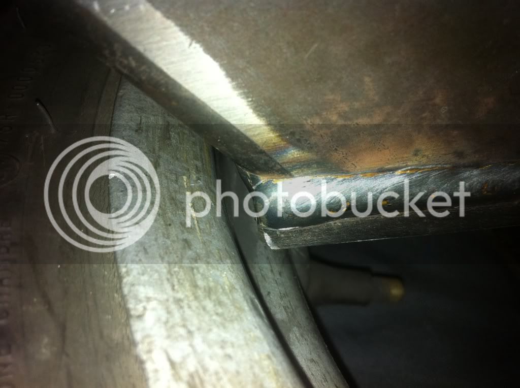

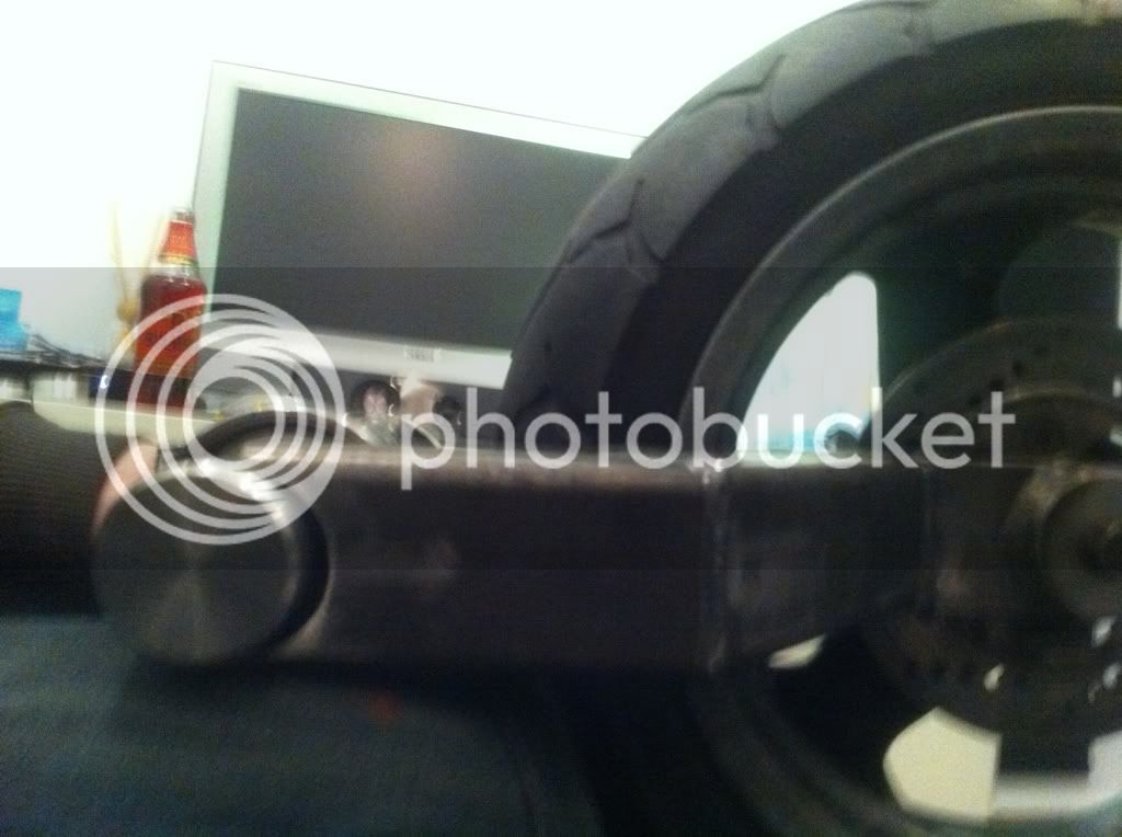

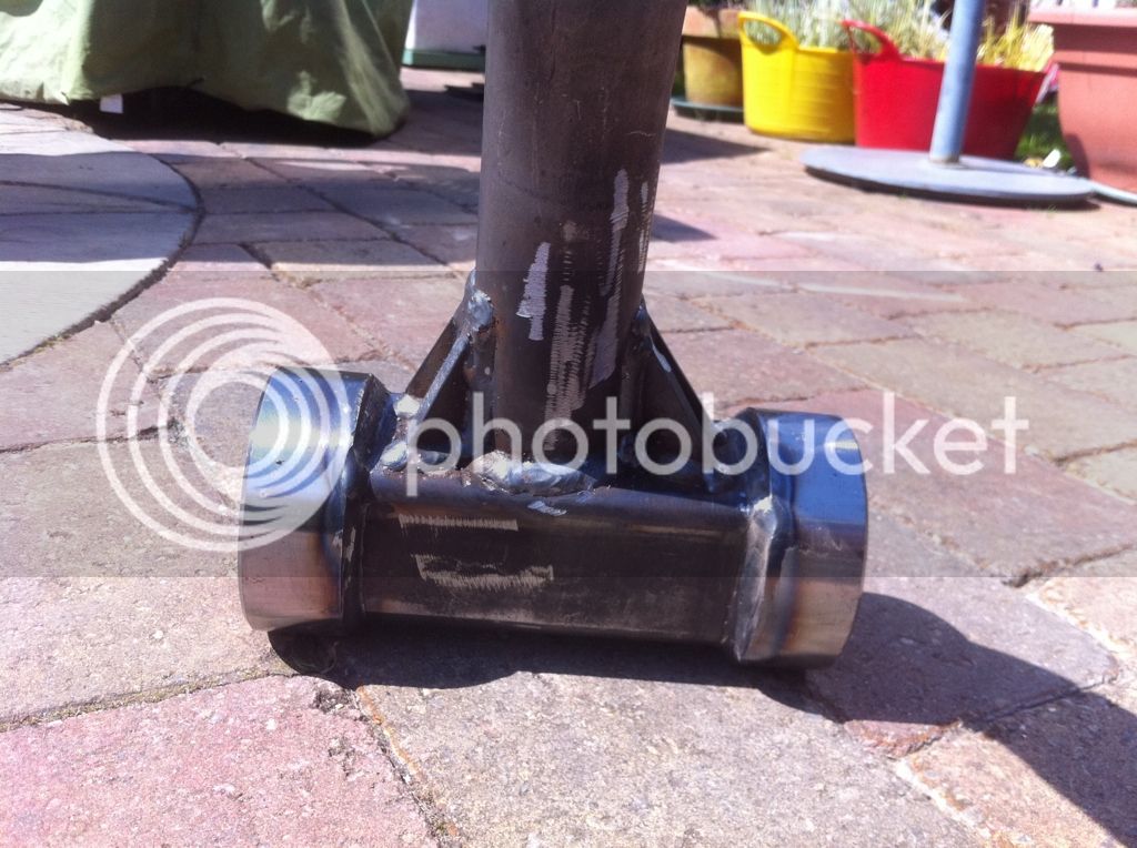

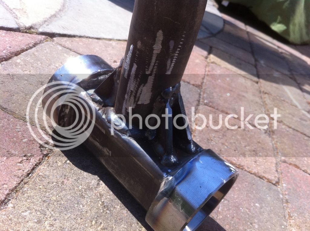

Made and welded the gussets on today. Ground the weld of from the tube to the box and welded again as I wasn't happy with the penetration or look of the welds. Also will be grinded the weld of off the swing arm. This I will take to work to get welded as my set at home just didn't seem to put enough heat into the swing arm shaft.

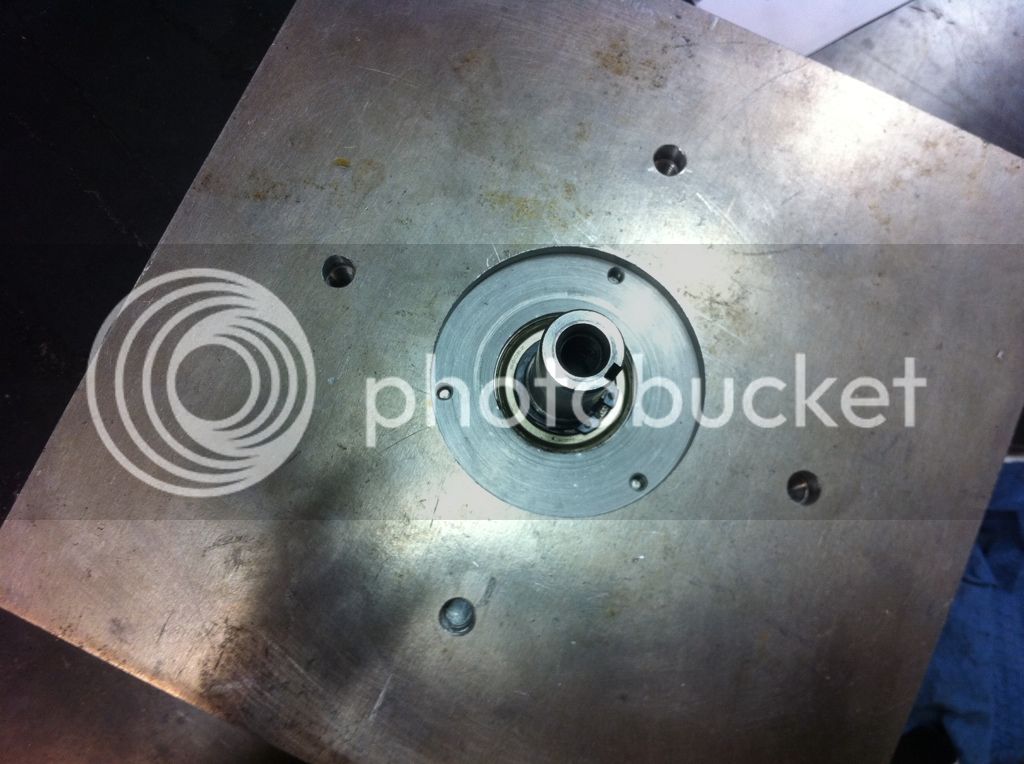

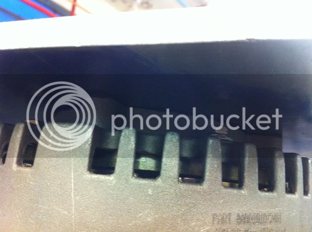

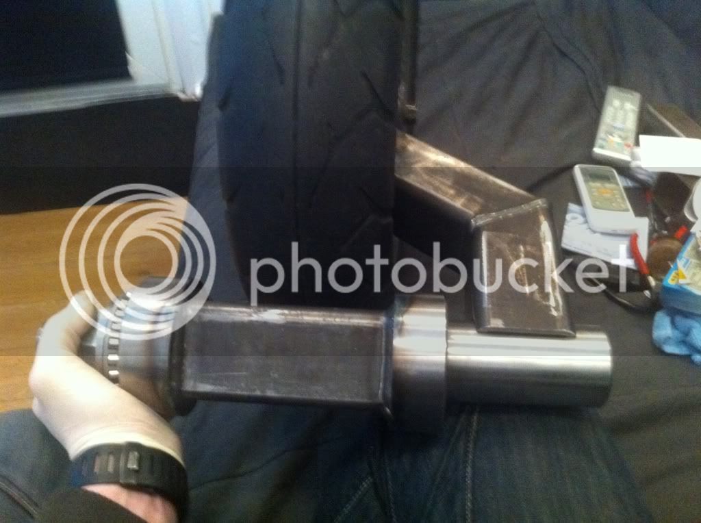

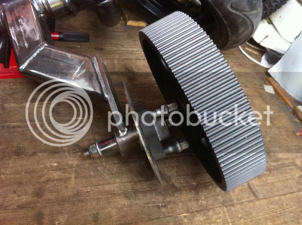

Been busy on the drive side of the scooter. Looking at mounting the rear pulley and starting to make a motor mount.

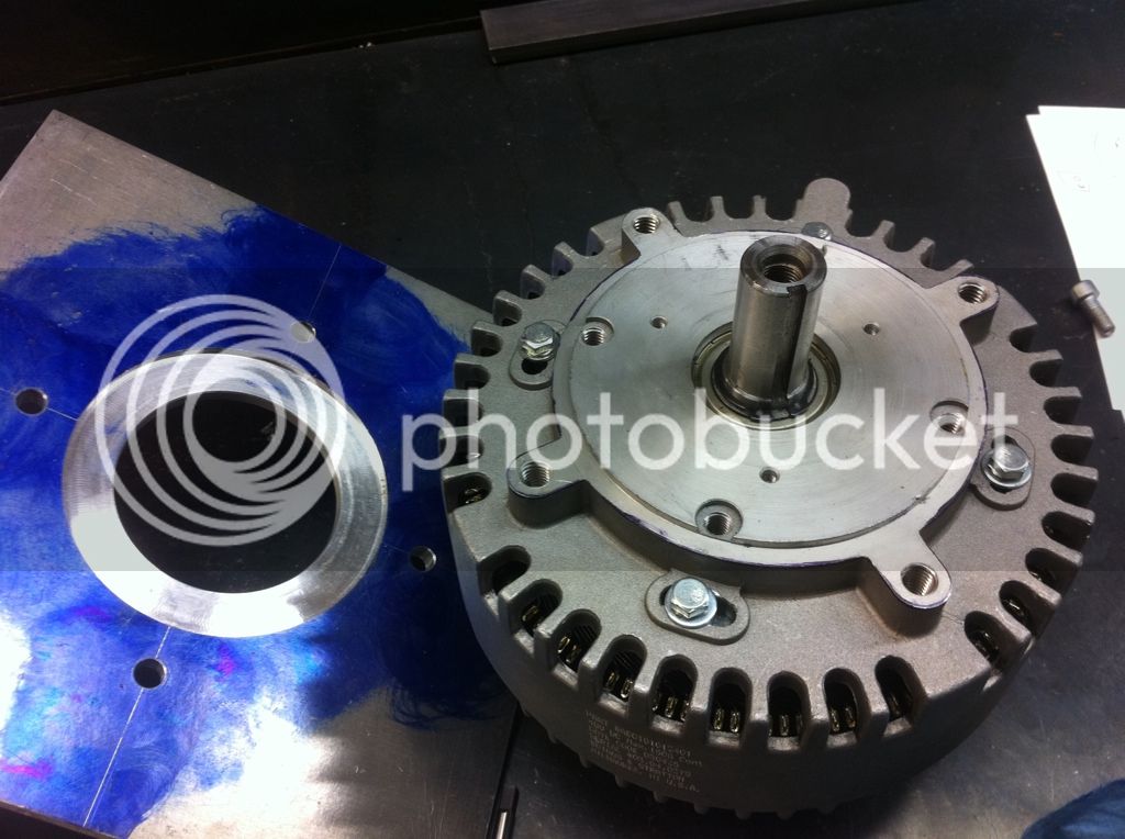

i am going to mount the motor on a 10mm aluminium plate, which will then bolt to an adjustable steel motor mount welded to the frame.

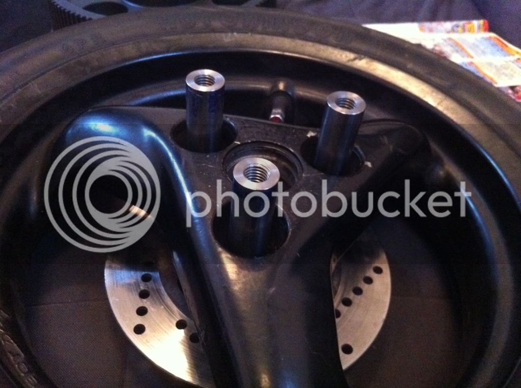

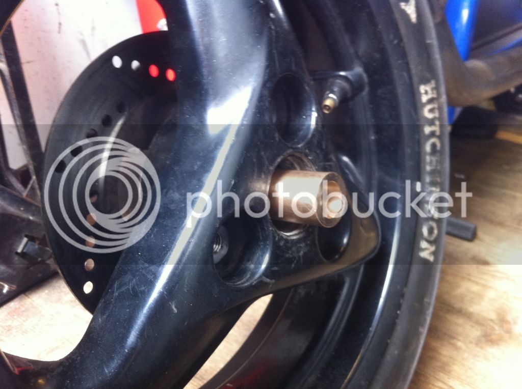

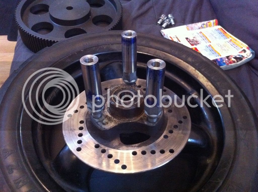

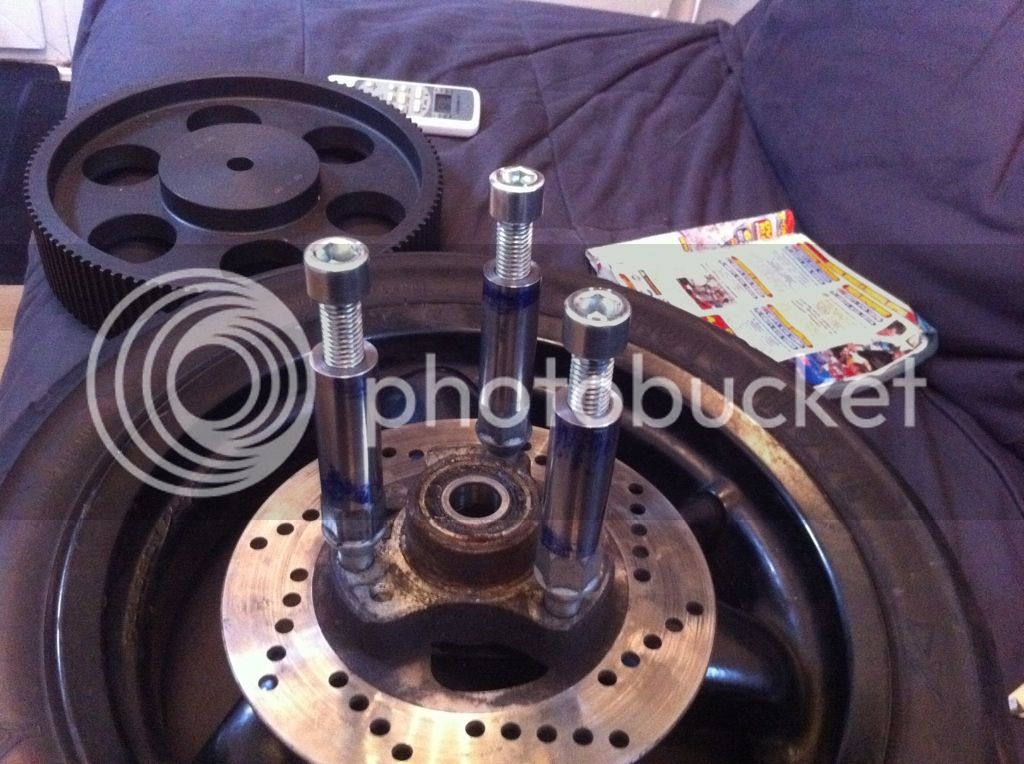

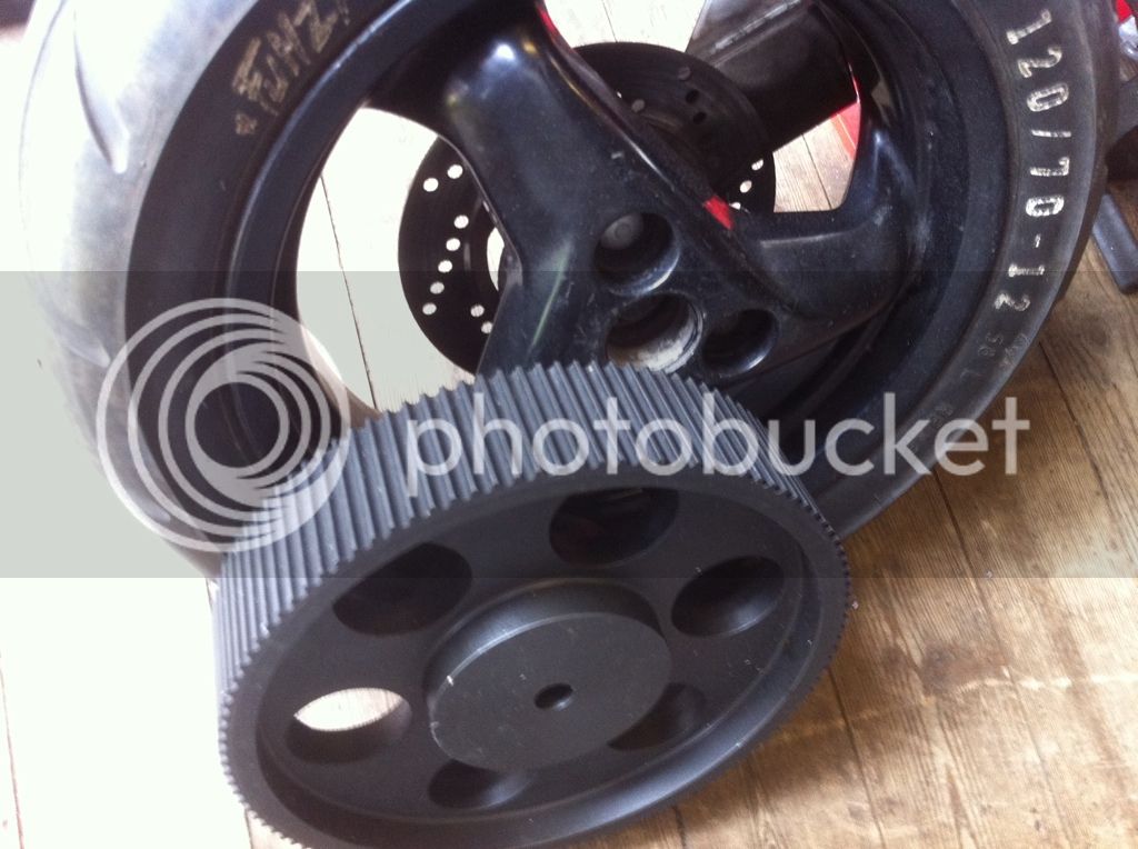

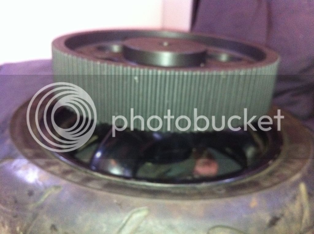

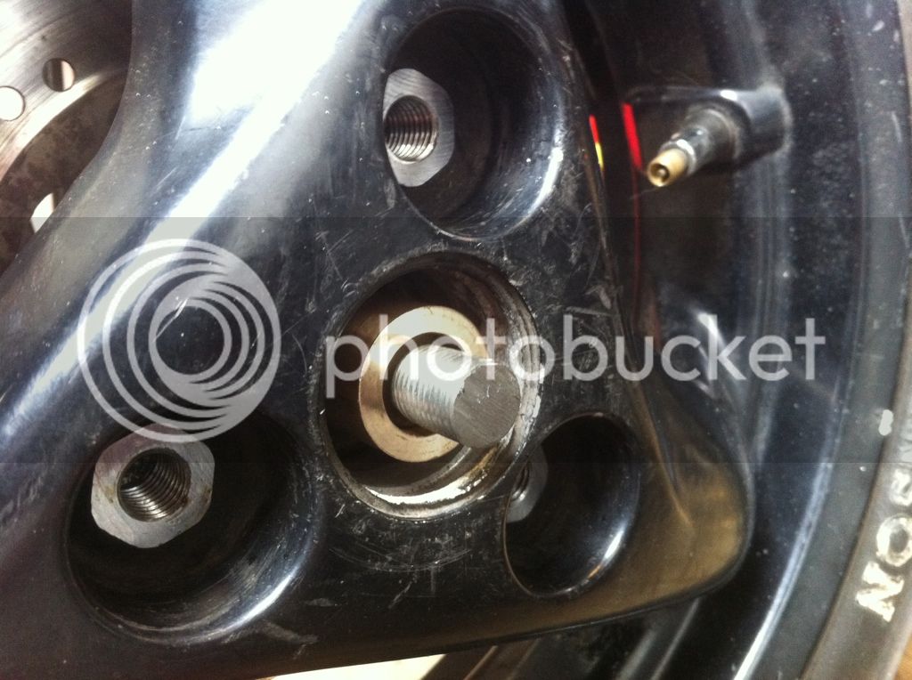

Since the scooter is a single sided swing arm, the only way I am going to be able to mount the rear pulley is by drilling and tapping the wheel nuts, and mounted of off them.

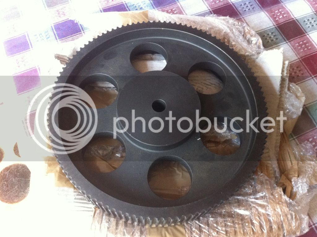

the drive is going to be 50mm wide 8mm pitch HTD belt. The ratio is 1 to 4. The rear sprocket is 112 tooth which is a particularly large size sprocket. I am using a cast iron pulley as a representation, whilst an aluminium pulley is being made. As I want the send the cast iron pulley back I havnt machined it, so I have just place the pulley hub on top of the studs. However the studs will actually sit 30mm inside the hub bringing the pulley 30mm closer to the wheel. Leaving only 3mm clearance in the centre at it tightest point.
Few pictures of where I am at.

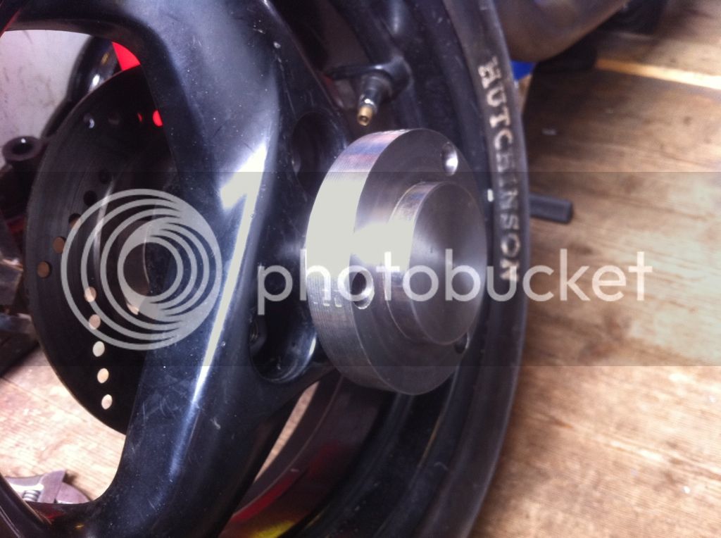

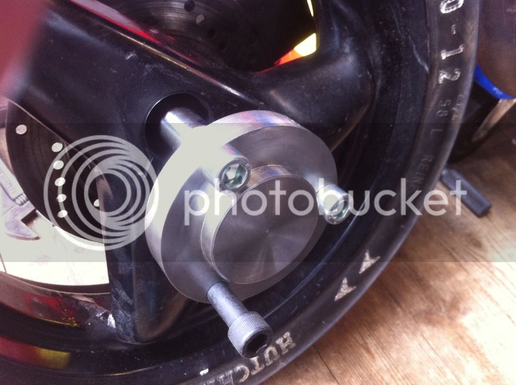

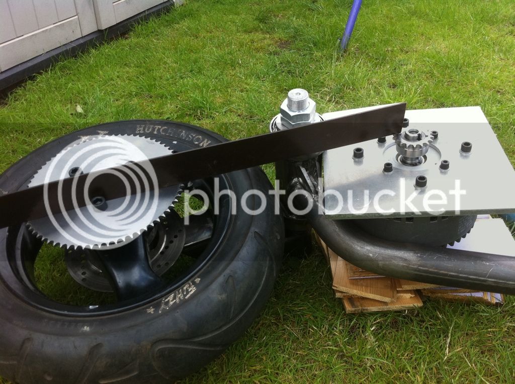

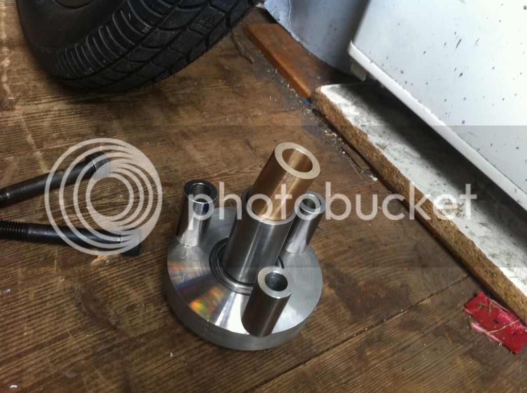

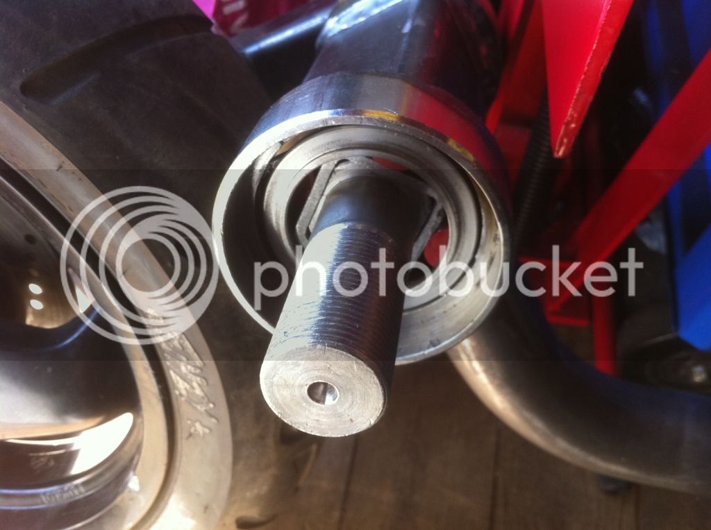

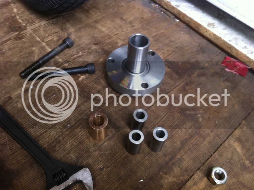

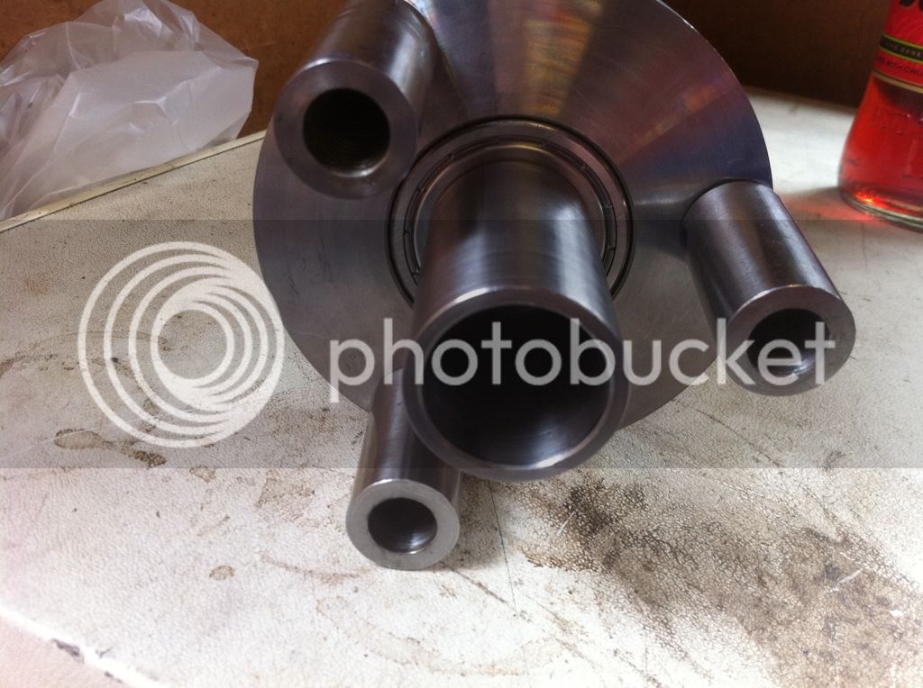

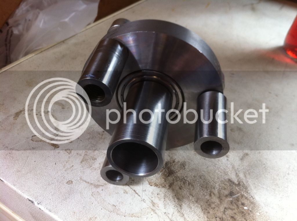

Been working on making a hub for the rear wheel. I decided that a 50mm belt is not really a good idea. The cost to manufacture an aluminium pulley is too much. I have decided to go to chain instead.

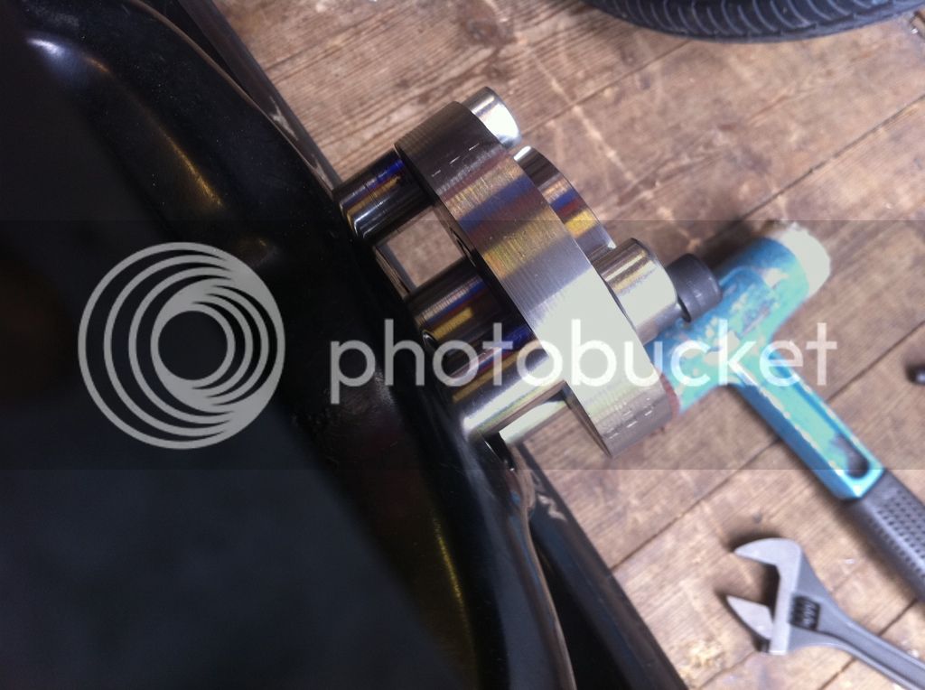

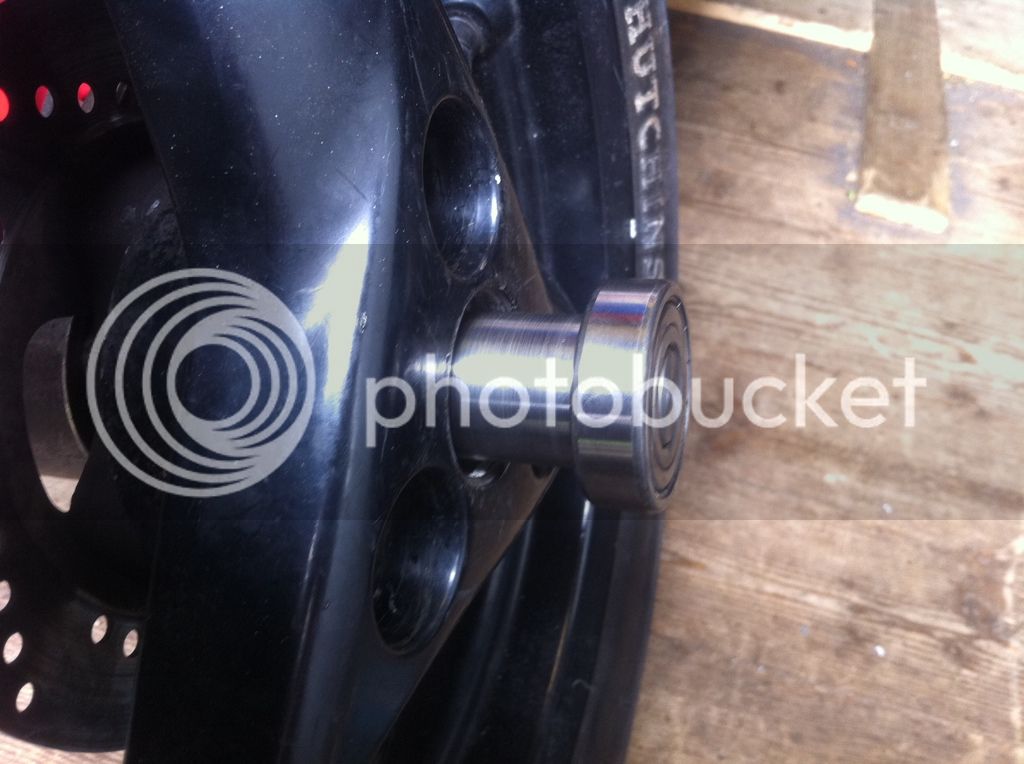

The hub I made uses a phosphor bronze bush which is bolted onto the shaft of the rear wheel. A sleeve from the hub with a bearing inside is tightly fit over the bush centering the hub. The sprocket will be bored to match the 60mm recess on the other side of the rod. It is all assemble on precision spacer via the tapped heads of the wheel nuts.
I have yet to get the sprockets delivered will only need to bore the out to 60mm then drill the bolt holes. The sprocket will then centre itself on the hub which runs in line with the wheel bearings, as all three bearings are on the same shaft.

Not decided on controller... But expect it will be 400amp Kelly. Batteries will be Lipo, turnigy. Using 8 series packs, in 2p8s configuration to give around 60v. Still working on the drive, got the hub and rear sprocket mounted. I am going to have to guide the chain either over or under the suspension knuckle as it looks like it is in the way. I am now working on making the steel motor mount which will weld to the frame and then the aluminium motor plate will bolt to it. Few pictures of where I am at.
