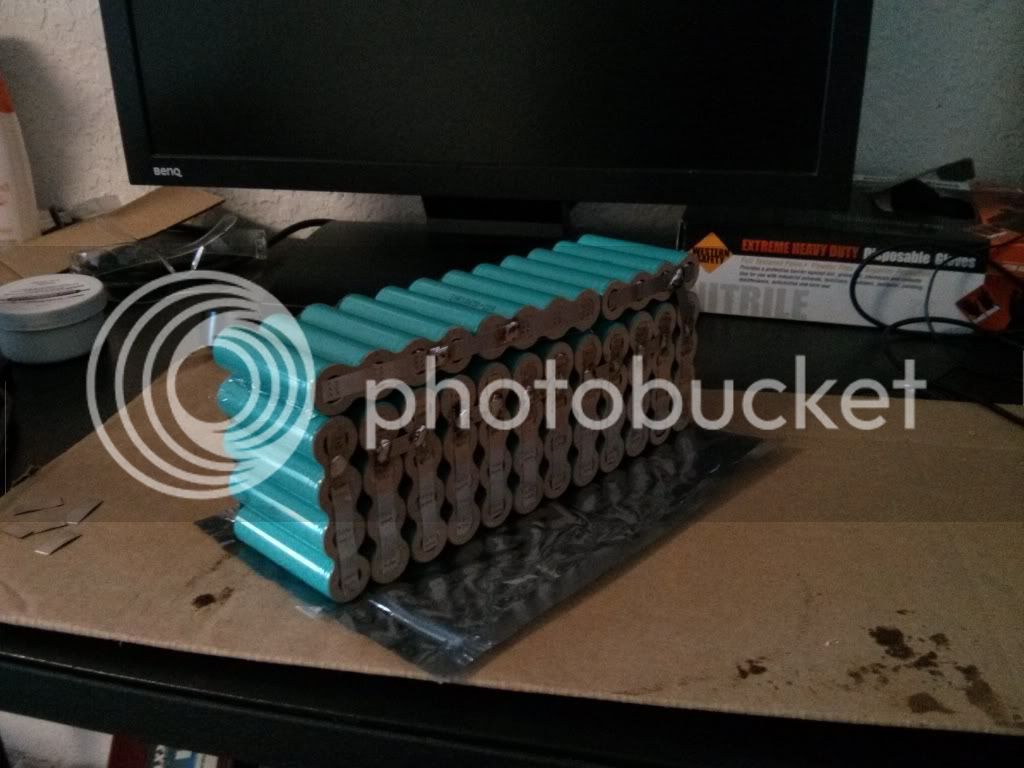

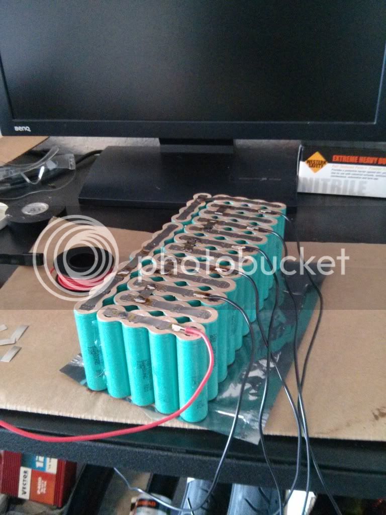

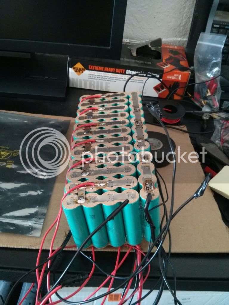

Continuing the build now arranged in 15s just need to add the balance leads, discharge wires and heatshrink wrap it.

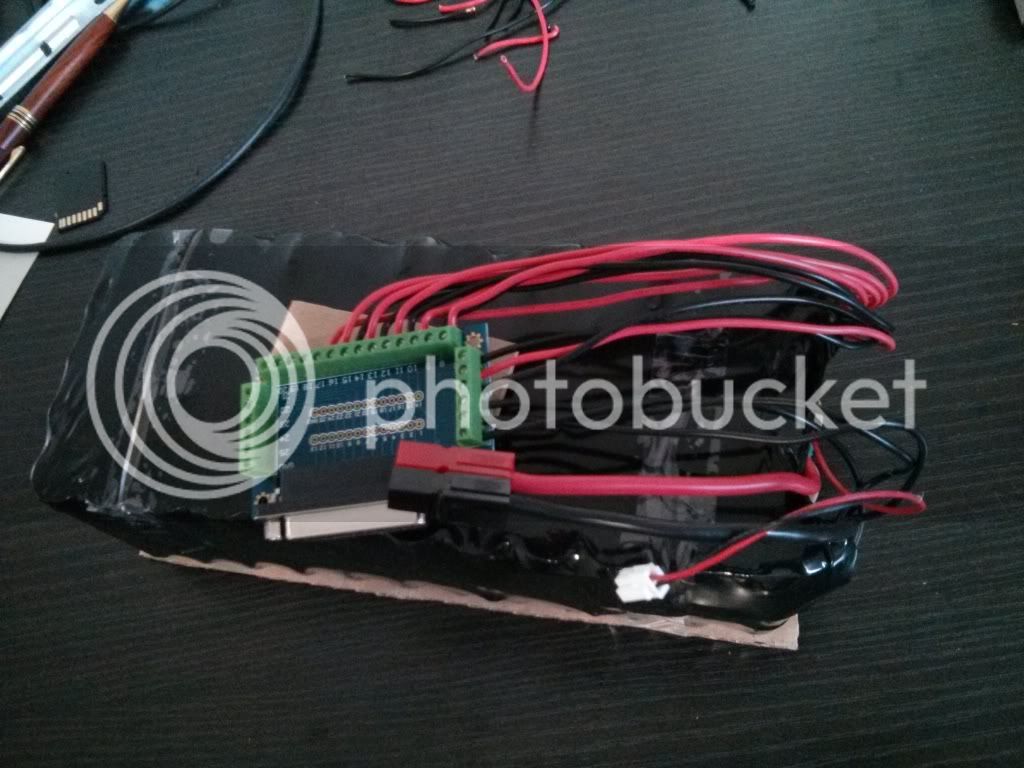

So I got around to finish this pack. It is a 15S 8Ah pretty compact pack. Added 22ga wire for balance wires to a DB25 breakout board for ease of balancing. I hope to enclose the breakout board in a small plastic enclosure or something. Discharge leads are 12ga cable with 45 amp andersons and a precharge plug already installed. The heatshrink I bought from batteryspace a while ago.

I don't have more pics but I can give you the seller.
These are VERY handy just make sure you have a flat screwdriver that has a really thin head. I found that 22ga wire was the limit as they fit in the holes but it was a tight fit (better for me)
http://cgi.ebay.com/ws/eBayISAPI.dll?ViewItem&item=300878978375
Please promise you won't buy em all as I have to make some more battery packs and will be using these.
I bought 2 one for the battery and one for the charger end. The charger I'm putting togeter is based off what jeremy did a while ago with the little titan chargers. I also bought a large quantity of 3S plus to make em so that I could connect it to the 3S balancer and the cables go to the breakout board. Then it is a matter of using a DB25 male to male extension as a charging plug.
The two wire plug is for my precharge.

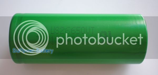

We'll see what this year brings. I also saw that supowerbattery is also selling SONY 26650 2.6Ah 50amp capable cells.

$12, 26mm diameter / 65mm long (SE US26650VT T C111GQB11V), Free spot welded tabs and grouped cells
http://www.ebay.com/itm/SONY-Lithiu...US_Rechargeable_Batteries&hash=item338268e7fc

I think that Sony cell is neat BUT they are expensive compared to the 20r. Also I can't find a discharge graph for it but supposedly it can do 50 amps discharge. On their last shipment they included one of the sony cells for me to test. We'll see how they perform but the price is a bit steep.
