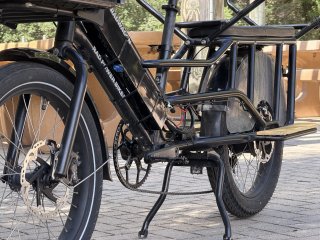

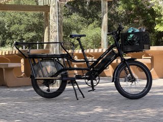

Been looking at the RadWagon 4 and was actually wondering about that.
